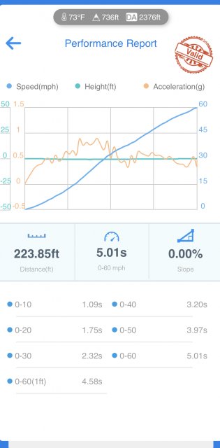

Thank you for the questions....no extra weight, I did get the launch control message. Here is one run.
I am going to try some runs on Map 2 today to see what that looks like.
#10
Your losing over a second from 50 to 60MPH, It should be around a half a second or less...

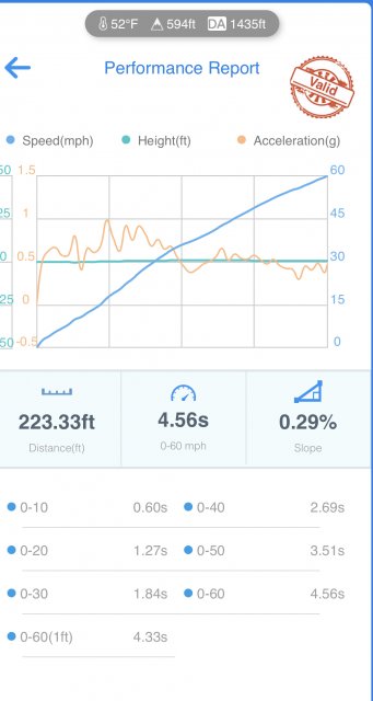

2,376 ft DA is pretty lousy air. 1,435 ft DA run is much better.
But the closer you get to Sea Level numbers (0 ft DA), the better.
