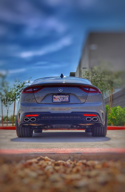

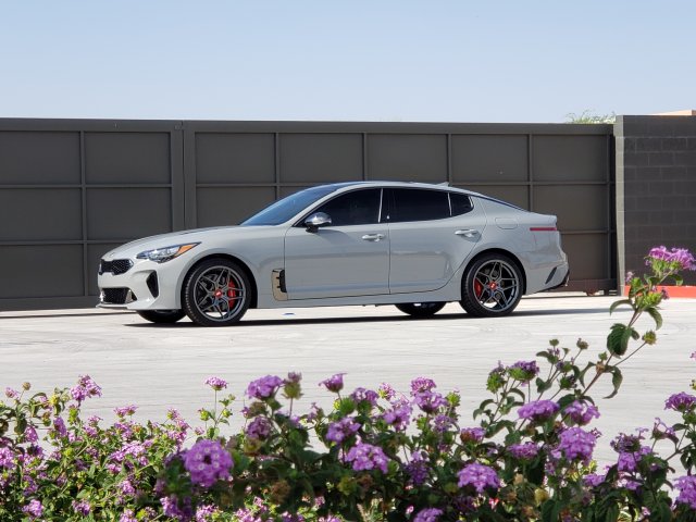

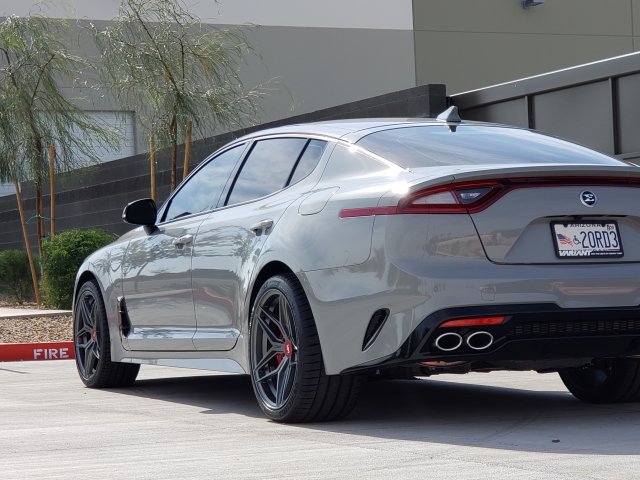

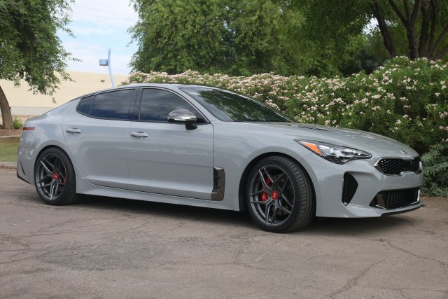

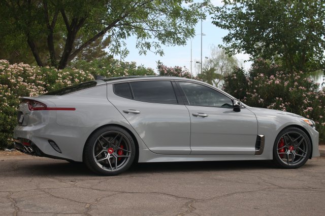

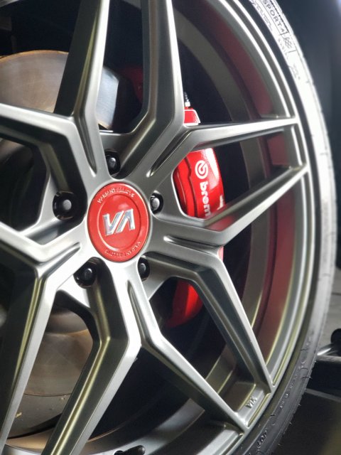

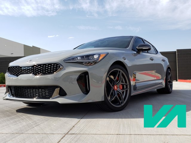

19x8.5 & 19x11s with 295s.... lookin good!
Location
Those look great.
Agree with @MiBlugt it needs a drop now. Get some ARK springs and that will put it at the perfect stance.

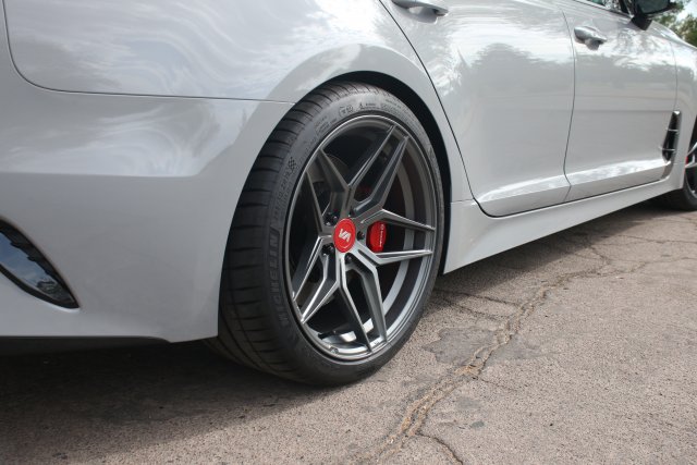

Yes, these wheels were cut for my car, If you have the stock sway bar endlinks, with the car off the ground the sway bar barely touches the inside if the wheel, so as long as you don't jump your car you will be fine. One thing about running that wide of a tire, your NOT going to be able to slam the car to the ground. I went with the Eibach pro lowering springs which dropped it an inch from stock height.

Oh nice. I think the drop is perfect and glad you mentioned it, as that was the route I was considering. I was thinking about actually including the front & rear sway bars too, the total Eibach package.
How does it ride compared to stock after the Eibach Pros?

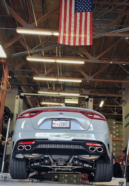

Over all it rides pretty good, it's a little stiffer in the front then the stock springs. Just make sure when you have the front springs installed that the bump stop is cut in half. With the setup I have, it handles nice around high speed corners, I'm satisfied with it.
You can take a look under my car in my GARAGE..

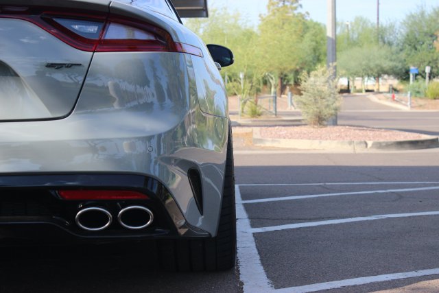

There is about a 1/4in of poke on the rear, if that...
