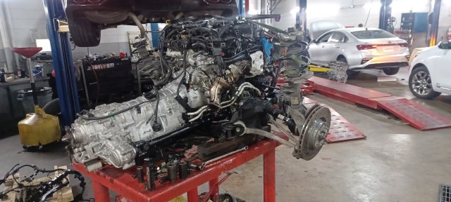

I am a kia technician and one of few who have done a stinger motor replacement, To answer your question yes it will fit, just make sure to keep your harness as the transmission plugs are different
