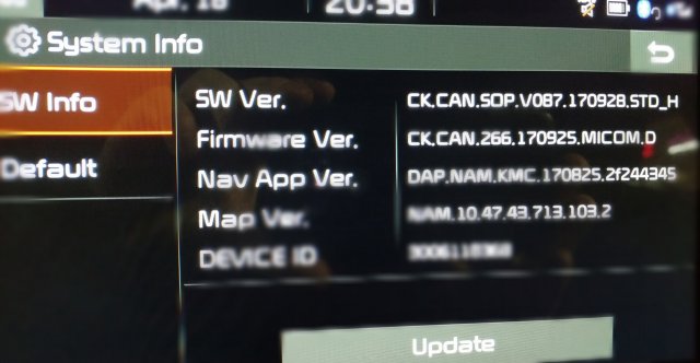

Hello Everyone!
Not sure if you already are aware of this: it looks like very soon in Canada maps updates for the Stinger will be free.
Found out yesterday while I was on the phone with Kia Canada and asking how I could get a free update from the website (as it clearly shows that we need to pay for it): the gentleman who was assisting me suggested me not to proceed and wait about one month or so when we will be receiving an email from them with info about the free updates.
Cheers.

That's quite the old version you are running.
Mine today is version 13.
I will have version 13.5 next week.
Yeah, in fact I can't wait to see the new update.
