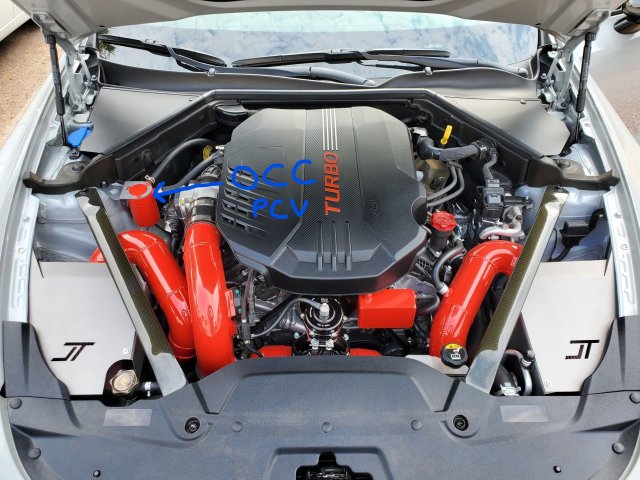

Welcome aboard, one of the more important mods is a Oil Catch Can on the PCV side of the motor. That will keep your manifold & the top of your valves from getting gummed up with oil. here's a photo of what I'm talking about.
