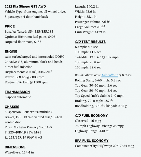

None so far... awaiting updates myself... Still don't know why I can't use launch control and have to resort to brake boosting off the line (for AWD ain't no thang...) Also the adapters would be nice... right now i have some electrical tape around them to hold in place :p When I'm running Map 3 and ~E30... i get 5 - 60 times in the 5.2s... which is what C&D got for a GT2. Not bad!

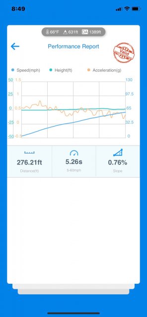

Okay... 5.26 seconds 5 - 60 Map 3 :) Getting there! Sometimes I'm getting a fuel cutoff or limp mode around 5000 rpm 1st - 2nd using launch mode with Map 3. Hmmm... so i had to do 5 - 60 instead. Anyone know why this is happening only using launch mode let me know! Fuel cutoff, blowout, limp mode for some reason... whatever... dunno :p Anyway ... 5.26 puts us at Stinger GT2 quickness @ 5 - 60mph anyhoo... not bad for a beta :p View attachment 4842
