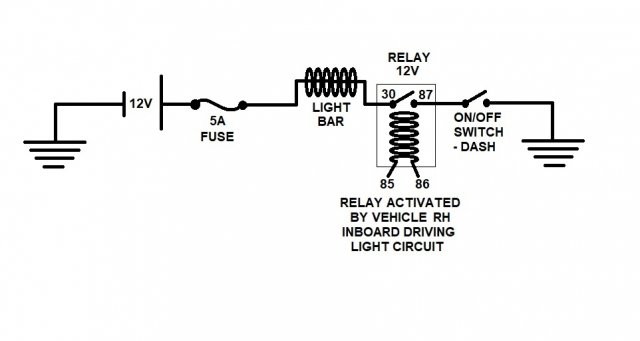

I have a Stinger GT with build date of Dec '22 (Sterling) with four LED headlights, two high/low beam and two high beam. I want to install a LED 12V 3.5A light bar and use the wiring from the right hand inboard high beam headlight to activate a relay via the relay connectors 85 & 86, for the light bar as per the attached schematic. I have not been able to get hold of a wiring diagram for Sterling and I don't want to try and pull him apart to find the wire codes as the connector on the back of the assembly is readily accessible and the harness can be easily spliced into. Can someone please tell me what are the wire colour codes for the inboard high beam lights?
