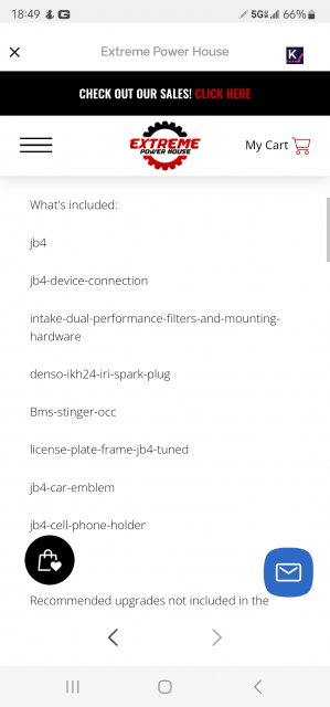

Just purchased a 2023 GT2. Looking at the following package. Not sure if it's ok or not. Plus a larger intercool. 1000000767.jpg
Don't buy the Denso spark plugs, there crap, buy the HKS M45iL. The HKS will cost more but you get what you pay for. I owned a JB4 back in the day, love it but I went with a ECU tune. The JB4 is nice because when you take your car to the dealership it's easy to remove.
I had a jb4 for years and it definitely gets the job done. There's a new tuner option though that people are excited about since it's a full ecu tune that can be done remotely using a handheld unit. So, easy to change maps and flash back to stock when going in for service.
If you're still looking, check it out: https://sxthelement.com/ek1-pro/

Look at the package deal over on K8 Stinger store. Injen dual intakes, dual ADD-W1 catch cans, HKS plugs, JB4 and bluetooth adaptor, MBRP cat back exhaust. All for around 2900.00.
