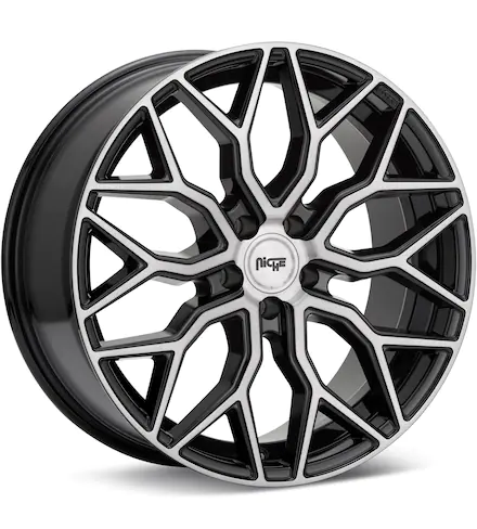

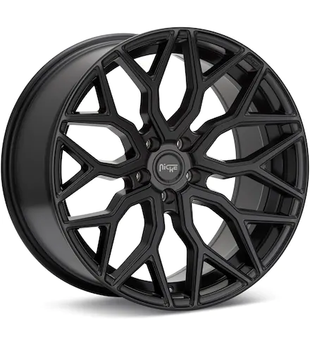

Hi folks,
I just picked up my '23 G70 Sport Prestige and of course I want to change the wheels... I only want to change the look and not the size. I want to use the pilot sport tires that came with my car. My question is, since the stock wheels are staggered (8.0"F & 8.5"R) and nobody seems to offer 8.0" anywhere, is it okay to use 8.5" up front with the stock 225 tire? And... if I use the 8.5" up front should I seek out a 9.0" for the rear? Just looking for some factual guidance and not someone's guess or opinion. I'm looking at the Niche Mazzanti wheels...
Thanks for any and all responses...

Welcome, yes you can run a 8.5F & 9.0R

Hey Mike, Welcome aboard. You can use the 225 tires on 8.5 inch width wheel and 255 tires on 9 inch width wheel. Let us know if there's anything we can help, feel free to reach out if you have any question
