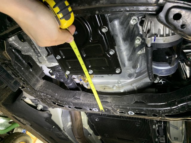

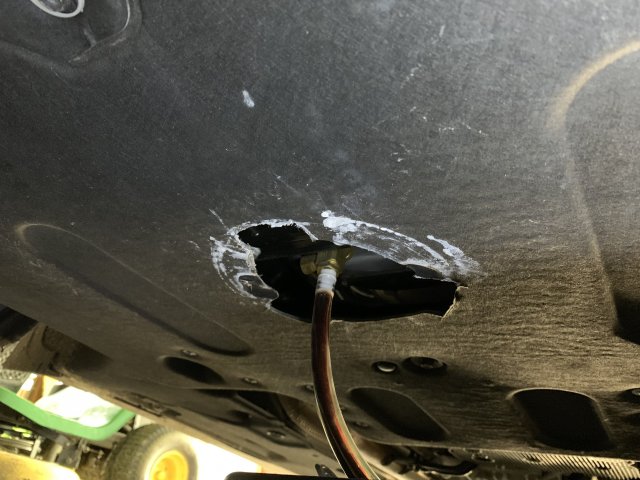

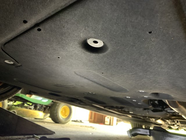

Currently a little frustrated at all of the prep work needed to drain the oil. KIA was nice to include an access hole for the filter but completely skipped over the drain plug.
Here’s my fix in process.
1) Fumoto F106SX M14-1.5 SX Series Drain Valve https://www.amazon.com/dp/B01HP5V092/ref=cm_sw_r_cp_api_i_rj7NCb97S7W25

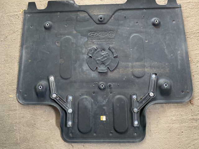

2) 29121-J5000, Access cover
https://www.kiapartsnow.com/genuine/kia-0~29121j5000.html
This will finish on the next oil change, I have the cover on order now and plan to mirror the front splash shield cut out. This way the panels can stay up while access is allowed.

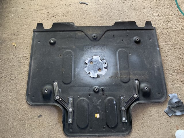

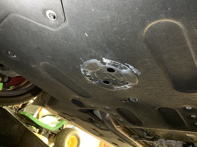

Finally got to work on this project. Don’t make the same mistake I did, DO NOT USE paint to mark a template. The splash shield just absorbs it and makes a mess of it all.
All in all, perfect $7 project for the Stinger.
Tools needed
Utility Blade with new blade
Drill bit

It’s definitely still a pain, the only solution I can think of is to buy a second splash shield to cut a “plug” out from to be able to enlarge the access hole. Notched properly it should work.
