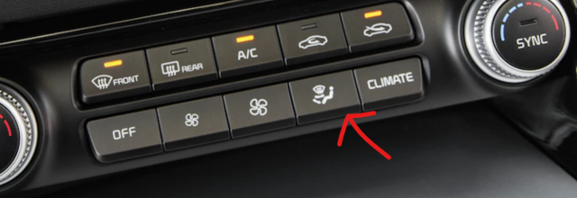

I have yet to bring it in to fix it as I don't have another vehicle but I found exactly what the problem was in my case.
So... In my car, it is the motor in the AC that switches where the airflow is directed (Body, Feet, Windshield). If I am to cycle through all the modes, nothing occurs until I get back to the body setting. You can try cycling through each of your AC locations and waiting about 5-10 seconds to see if the sound occurs. I found that it is consistently when I turn it to the body setting.
I always leave my AC on the body setting so this occasionally happens upon start up and when I turn the car off. I will say that the problem rarely happens now which probably isn't a good thing, maybe the motor gears are sheering I'm not sure. Either way, I hope this helped and if you go as far as to fix it before I do, please post and let me know the solution you found.
I have the same problem! and I do the same thing I turn the air conditioning up to stop listening the noise 😳😭
