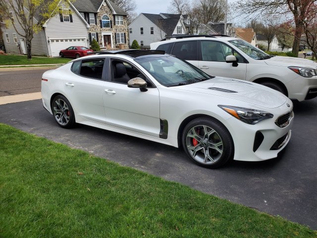

I got lucky and found a white 2019 GT1 at a local dealership and just picked it up this weekend. A few more miles (11k vs 30k on this one), but the car is in better shape and there's a couple extra features the 2019s come with like ventilated seats and wireless phone charger. This was a giant PITA but in the end I think I ended up with a better car.
