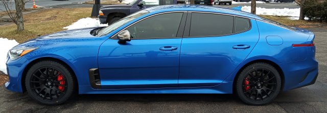

Motegi MR118, 18x8, 32 mm offset; Dunlop WinterMaxx 225/45/18 WM02. Looks good enough for winter, the tires ride very nicely but there I haven't had any weather to truly test them. stinger wheels 2.jpg
