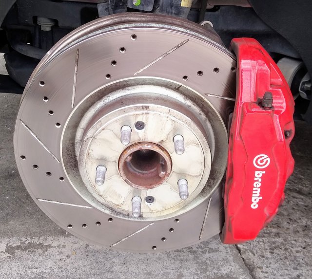

Im the happy owner of a 2020 GT2 Stinger, I love the car, by far one of the best all around I've owned! (I had a 1997 , 911 Turbo)
having said that
the Breaks Issue has been and continues to be a big problem.
1st of
Every single Kia service dealer manager that I have taken my car for service about
my breaks problem with the Stinger knows about this problem.
Here's where I had the car serviced:
Bridgewater NJ Kia, Dallas TX Southwest Kia, Fremont CA Wynn Kia
The Breaks where not engineered correctly for this almost perfect price-performance GT sports sedan.
We are all paying the extra price for this critical and poorly engineered part of our cars.
I am now on my 3rd set of break rotors and pads. My car now has 42,300 Miles.
So I'm basically getting around 14,000 miles per rotor & pad set (all 4)
The 1st two sets I just had them replaced with the Kia recommended solution (bad idea)
I wish I would have search for this forum 1st
The current set, a performance package recommended by the Kia service manager at Bridgewater NJ Kia
is now failing too (shaking when braking).
Here's my current setup:

To me, It is beyond any doubt that The Breaks where not engineered correctly.
If I was a lawyer (I'm not)
I would be collecting signatures for a a petition or something from all the US Stinger owners
to have Kia rectify and replace the breaks at their expense.
I'm about to replace the rotors and the pads again (4th time)
I will replace them after I drive from Fremont CA to Dallas this coming week.
Can you guys tell me what is the absolute best performing and lasting
breaks rotor & pad set based on experience.
I will like this next set to last a longer than the 14K miles I'm getting, maybe 30K miles...
Thank you all!

I've never had a problem with my brakes, but I also don't drive my car every day because I don't work, but when I brake hard the car stops. Here some websites to buy some.
Rotors : Khartunerz, It's Never Finished
Kia Stinger 3.3T - Fella Lightweight Brake Rotors Upgrade – K8 Stinger Store
Kia Stinger - Fella Big Brake Kit – K8 Stinger Store
Kia Stinger 3.3T - GiroDisc Brake Rotors – K8 Stinger Store
