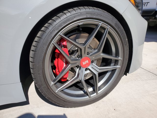

I'm thinking about trying the brake pads in the picture below eventually they are priced fair and they have to be better than stock. I believe the stinger and G70 use the exact same brake pads some manufacturers list both cars and some manufacturers only list one of them.

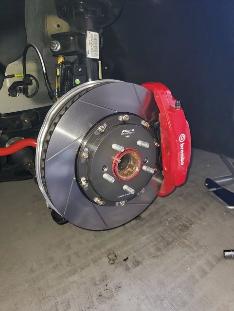

Replaced mine with all 4 corners, FELLA 2 piece rotors & Stoptech performance pads.
How are you liking your new brakes, any issues?
How much were the rotors? They do look sharp!
1,797
#31
The rotors work awesome, I also have steel braided brake lines & performance brake pads, feels like a different car. I bought the rotors on sale so I payed 1500 normally they are 1900.

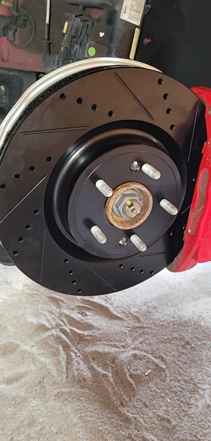

Disc Brake Kit, PowerStop - F&R Z26 Street Performance Brake Pad and Drilled & Slotted Rotor Kit
To me, It is beyond any doubt that The Breaks where not engineered correctly.
