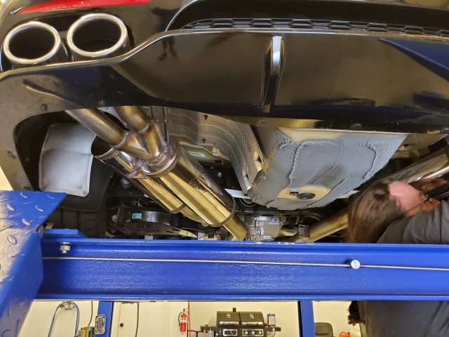

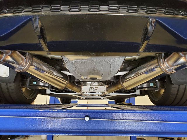

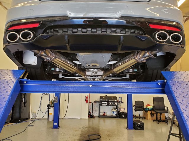

Had my Magnaflow exhaust installed on Tuesday, I know there's a few people out their that say it's to quiet but for me I love the sound.

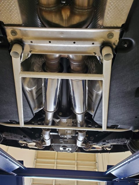

Added two stainless steel resonators to my ark midpipes and love it.
Without the resonators there was drone from 2-2500 or so rpm (cruising speeds). I loved the extra gurgle I was getting from the removal of the secondary cats but the drone it created was to much even after I put sound dampening in the trunk.
I added Borla straight through honeycomb resonators and the sound is back at our near stock and because the exhaust is defused via the honeycomb and does not hit any packing material I get to keep the change in sound. To me this is how a cat delete midpipe upgrade should be made:)
I don’t want super loud and decided against a cat back because of what the midpipes did, now however I will be following spider55 and adding the magnaflow for the deeper note:)
If you have midpipes and the increase in drone bugs you like it did me, and u don’t want to go back to stock with cats this is the answer!
Honestly, knowing what I know now I would just have someone cut out the cats and add resonators in its place, but love what I have now:)
649
Very nice! those welds look great...Any sound clips of it?
Also that passenger side seems awfully close to that heat shield and floor board compared to the drivers, needs a bit more clearance.

Yes, that pic is before we finished, we added a metal spacer to the black bracket after that pic to move it down, it’s in no danger of hitting.

That is still the before pic, I forgot to take pic after the extra spacers added but there is plenty of room.
